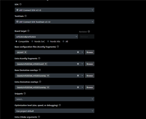

I am trying to build the code for AOA example for nrf52833dk_nrf52833 dk from the example code avaliable on the sample called direction_finding_central. i have nrf connect sdk version of 3.1.0. When i try to just build the code using this build configuration
With sysbuild being default i got the following  build errors:

    Please note however that when you have already chosen the Board target of nrf52833dk/nrf52833, it is not necessary to choose any of the fragments or overlays. I don't think that is the cause of the build errors, though, since my testing here do not reproduce the errors even for a build configuration with those added.
