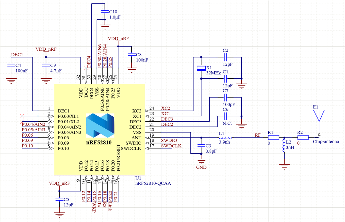

I have created my module with nrf52810 QFN32, loaded softdevice,loaded app,enter debug mode with keil.
It can run without error,but
1) the BLE did not start-up,for can't find the module with mobile app nrfConnect;
2) it may trigger the error :"SOFTDEVICE: ASSERTION FAILED",and the PC=0x12214.
    My app code start from 0x1C000,so code in softdevice space triggered it,but I can't find out which function call triggered that.

    I misunderstanded the build code,the build code for my chip is "C0",that is mass production devices.
    So,the reason BLE not started maybe related to hardware, for the app can work on other board.

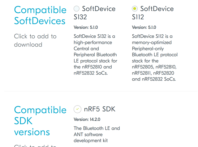

    3) can use nrf5 SDK17.1 + S113 7.2 to develop for nrf52810?
    If answer to those question is yes,then why can't find the device with nrfConnect app?
    Maybe:
    1)oscillater is not stable;
    2)problem on antenna circuit;
    3)some functions to SD for "C0" build does not work.
    Any other reason?
