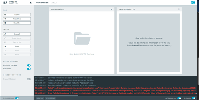

I am trying to flash an ADC+BLE code to my custom nrf board having nRF52840 chip on it.
I connected it through nRF52DK to flash a code, but when I am running nrfjprog --recover in command prompt it shows the above error.
Also if I try to open it with nRF Programmer it shows the below screen.
17:34:10.276
Selecting device with the serial number 000682572528
17:34:11.076
Error: Failed with exit code 1. One or more device info tasks failed: * 682572528: Device error: Setting the debug port SELECT register failed while powering up sys and debug regions (Unknown Error in J-Link DLL (error code =-1)). This might indicate that the debug port is unavailable. Please double-check device power supply and SWD lines, and that SWD isn't disabled (Generic) Message: Operation device-info failed, Device error: Setting the debug port SELECT register failed while powering up sys and debug regions (Unknown Error in J-Link DLL (error code =-1)). This might indicate that the debug port is unavailable. Please double-check device power supply and SWD lines, and that SWD isn't disabled.

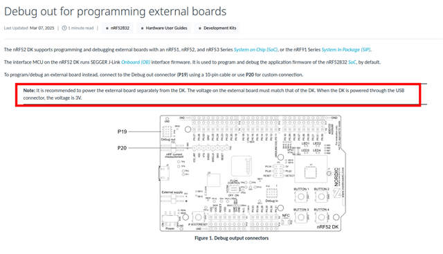

Pin Connections:
Sl no. nRF52DK Pins Custom board Pins
1 Gnd GND
2 VTG (Sorted to VDD) Vcc
3 SWDIO SWDIO
4 SWDCLK SWDCLK
