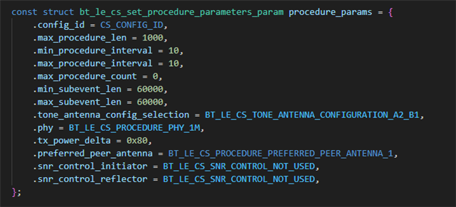

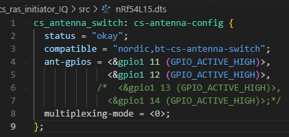

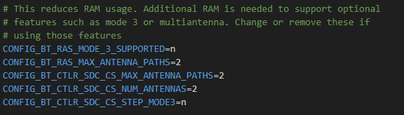

Can anyone guide me the process of connecting multiple antennas with the nordic kit. I dont find exact information about the RF switch (GPIO-controlled antenna switches with switching time less than 6 micro seconds ) with configuration and any links to buy. I mean to ask about the harware pheripheral which can be used for mulitple antenna support. Thanks
