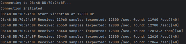

For Example: If connect one sensor to a host, the throughput is limited by the theroetical maximum of ~700kB/s (we're using 1M PHY and max. MTU, see Bluetooth Low Energy data throughput), here is an example:
It shows ~12000 data samples per second; One Data sample are 6 Bytes (48 Bit), so the bitrate is ~600 kBit/s which is close to the maximum. The sample rate is 12800 Hz, so the data throughput is fine and close the the desired data rate.

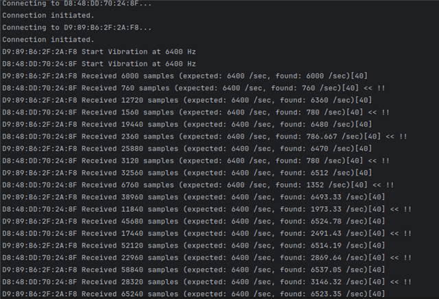

Now, If we connect 2 devices with the half frame rate (6400 Hz) which is in summary also 12800 Hz, it should also fit to the maximum throughput , but it's not:
The second device never reaches the full bandwidth of 6400 Hz.

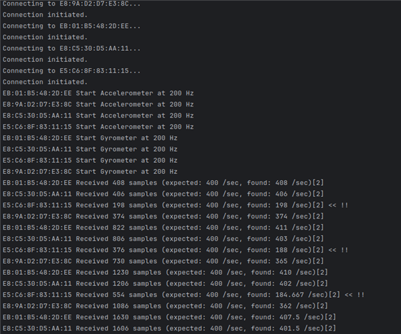

It's getting even worse with more device, in example 200 Hz and 4 devices which is far from the limit:
200 Hz Acc + Gyro are 12 Bytes per sample which is ~20 kBit/s. There should be no problem at all, but it is. One of the nodes is always below the designed frame rate.
