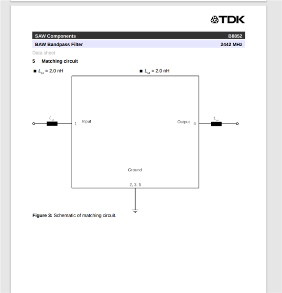

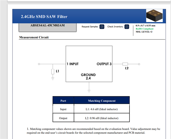

We are working on a project based on the Thingy91x which uses the following SAW filter : SAFFB2G45MA0F0A. Unfortunately this part seems to be out of stock everywhere I looked? I found these two parts that seem to be suitable replacement : B39242B8852P810 or ABSES4AL-45CM03AM.
Would it be possible for you to help me find the best alternative? Either of the two component above or something else?
