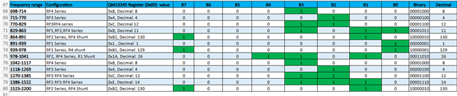

Due to the size limitations of the equipment, it is difficult to operate the low-frequency range of 700Mhz to 960Mhz for cellular antennas, and it is necessary to switch them through a harmonic switch.
There are two communication methods between nrf9151 and the RF harmonic switch: GPIO and MIPI. nRF9151 controls this communication automatically by the modem, and users cannot modify it by themselves. The current solution selection of the customer is based on thingy: The reference design for 91 is QM13345. nRF9151 communicates with QM13345 through the MIPI interface. Now, we need to know what frequency bands QM13345 RF1/RF2/RF3/RF4 correspond to respectively?
