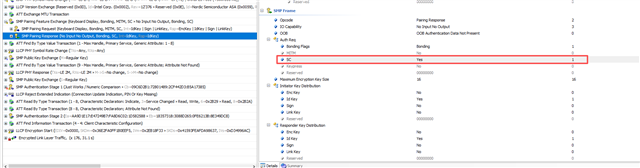

    Thanks for the suggestion! Unfortunately, those parameter settings still didn’t achieve what I need. I’ve attached a screenshot of the capture I took with Ellisys Bluetooth Analyzer. My goal is to force the SC bit to 0 so I can analyze the data without having to enter the SC LTK for decryption every time.
    Looking forward to your reply!
    Ozzy

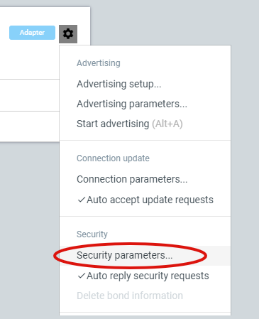

    What is the peer device?
    If for instance it is the Bluetooth Low Energy app in nRF Connect for Desktop, then you can control the security parameters from the drop-down menu on the cogwheel of the connectivity device:
    Terje
