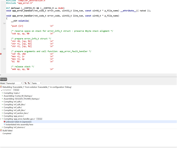

  • hello,Could you please help me figure out how to fix this issue? Here is my code and a screenshot of the error.

    /*================= 必要的错误/断言回调 =================*/
    void app_error_handler(uint32_t error_code, uint32_t line_num, const uint8_t * p_file_name)
    (void)error_code; (void)line_num; (void)p_file_name;
    __disable_irq();
    while (1) { __WFE(); }
    // SoftDevice 断言回调(nrf_sdh.c 需要)
    app_error_handler(0xDEADBEEF, line_num, p_file_name);
