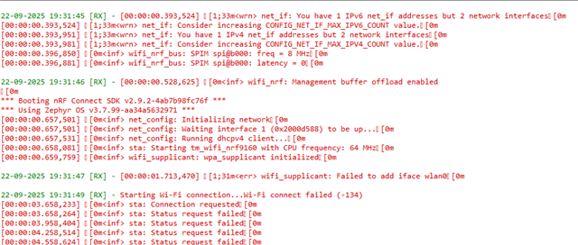

I am using a custom nRF9160 board with the nRF7002 Wi-Fi chip via SPI, running NCS v2.9.2. My goal is to connect to a Wi-Fi network.
However, during initialization, I see the following logs:
[RX] - wifi_supplicant: Failed to add iface wlan0
[RX] - Starting Wi-Fi connection...Wi-Fi connect failed (-134)

  • Hi, thanks for the response.
    This is a fully custom board that we designed and developed (not a DK). The board integrates an nRF9160 + nRF7002 over SPI.
    We have already provisioned the nRF7002, and scanning works fine (we can see available APs). However, when attempting to connect, the connection fails with the following logs:
    So the issue is not with scanning, but specifically with establishing the Wi-Fi connection.
