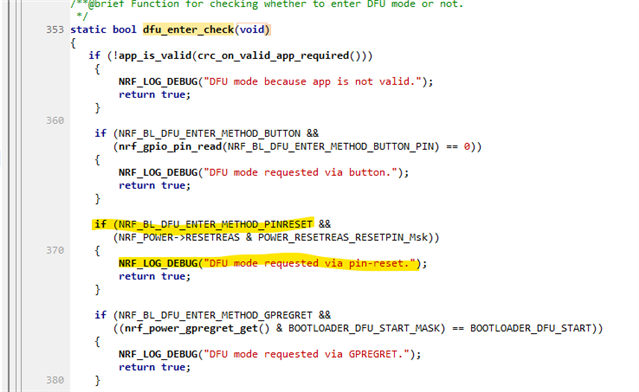

    Putting the nRF52840 dongle to DFU mode is quite simple. During booting up, the bootloader will check for the reset reason and if it's s a pin reset it will enter DFU mode. You can find this code in the bootloader (nrf_bootloader.c):

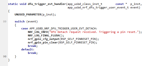

    So the task for the application is to toggle a GPIO pin that connect externally to the reset pin to trigger a pin reset from the software. This is exactly what the DFU trigger library does.
    You can find many of our application for the dongle already support this, for example you can switch between the firmware for the NRF52840 dongle for nRF Connect for Desktop -> Bluetooth Low Energy application and nRF Connect for Desktop -> RSSI viewer application without having to press any button. The firmware automatically switch to bootloader mode without any intervention to press any button.
    We will need to see how you implemented the DFU trigger library and what error you have. You can take a look at the \examples\connectivity\ble_connectivity\pca10059 to see how it's implemented.
    Or you can simply try a simple test to set BSP_SELF_PINRESET_PIN to 0 in your application code to see if the dongle switch to DFU mode or not (The LED breaths red). This code in nrf_dfu_trigger_usb.c put the chip to DFU mode:
