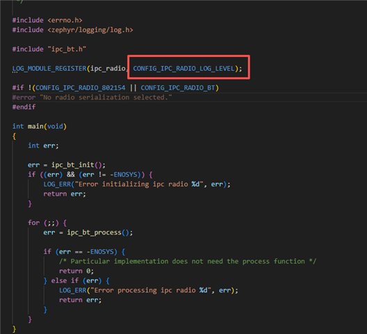

Bluetooth will force the next data packet transmission to wait until after the 7.5ms connection interval.
We are using the NRF5340 with a Bluetooth transparent transmission example routine. We have set the connection interval to 7.5ms and the transmission timing to 3ms (sending a 242-byte dummy data packet). We observed that Bluetooth can send data packets normally within the 7.5ms interval, but after sending the second data packet, Bluetooth forces the next transmission to wait until after the 7.5ms connection interval, which causes blockage on the transmitting end.
Currently, we have configured the connection event extension with CONFIG_BT_USER_DATA_LEN_UPDATE=y, CONFIG_BT_CTLR_DATA_LENGTH_MAX=251, and the GAP event interval with CONFIG_BT_CTLR_SDC_MAX_CONN_EVENT_LEN_DEFAULT=7500.
Are we missing any key configurations such as the "Connection event length extension" found in nRF52840, like setting opt.common_opt.conn_evt_evt.enable=true; err_code=sd_ble_opt_set(BLE_COMMON_OPT_CONN_EVT_EVT, &opt);? Or are there any existing configurations that need to be enabled in the main function?
  • Check .config file in build/zephyr, the default only has 3 TX buffers enabled:  CONFIG_BT_BUF_ACL_TX_COUNT=3
    That won't do for high throughput, try to increase to 10. Careful: Must be in sync with the net core firmware config IIRC. Note that this will increase RAM footprint on both cores.
  • bro,What does it mean by "must be synchronized with the network core firmware configuration, IIRC"? Is it referring to the prj.conf of ipc_radio or the main function? I wonder if it could be the CONFIG_IPC_RADIO_LOG_LEVEL in the main function of ipc_radio?
  • Take another look at the throughput sample. There is stuff in both prj.conf AND sysbuild/ipc_radio/prj.conf files.
  • Thanks bro
    I have checked the throughput sample repeatedly, and all the key configurations have been referenced. Here are all my current configurations and the main function for your reference.
