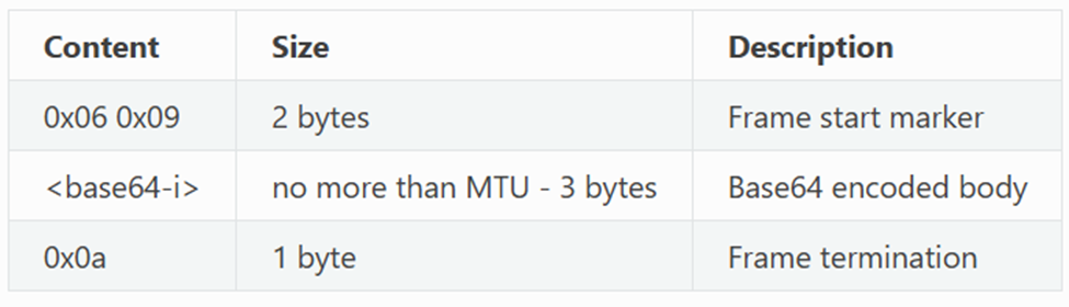

I’m trying to interpret the AuTerm messages sent via UART in order to create my own DFU controller. But at the moment I can’t interpret the frames.
I’m following this description:
-. https://docs.zephyrproject.org/latest/services/device_mgmt/smp_protocol.html
-. https://docs.zephyrproject.org/latest/services/device_mgmt/smp_transport.html?utm_source=chatgpt.com
Init packet (logic analyzer): 0x06, 0x09, 0x41, 0x42, 0x55, 0x44, 0x41, 0x41, 0x41, 0x4C, 0x41, 0x41, 0x47, 0x6E, 0x41, 0x62, 0x39, 0x69, 0x63, 0x6D, 0x4D, 0x41, 0x59, 0x32, 0x39, 0x6D, 0x5A, 0x67, 0x7A, 0x2F, 0x41, 0x4F, 0x34, 0x3D, 0x0A
Could you please confirm whether I’m defining all the bytes correctly? They don’t seem to have the correct values.
Start maker: 0x06 0x09
Res/Ver/OP: 0x41
Flags: 0x42
Data lenght: 0x55 0x44
Group ID: 0x41 0x41
Sequence Num: 0x41
Command ID: 0x4C
Body: From 0x41 to 0x4F (Base64)
CRC16: 0x34 0x3D
End: 0x0A
Could you also confirm whether I’m calculating the CRC‑16 correctly?
I’m obtaining 0x36 0x6C instead of 0x34 0x3D.

Note: I found the next function in the Auterm driver (Version 0.36a test release).
uint16_t crc16(const QByteArray *src, size_t i, size_t len, uint16_t polynomial,
               uint16_t initial_value, bool pad)
    uint16_t crc = initial_value;
    size_t padding = pad ? sizeof(crc) : 0;
    size_t b;
    /* src length + padding (if required) */
    while (i < (len + padding))
        for (b = 0; b < 8; b++) {
            uint16_t divide = crc & 0x8000UL;
            crc = (crc << 1U);
            /* choose input bytes or implicit trailing zeros */
            if (i < len) {
                crc |= !!(src->at(i) & (0x80U >> b));
            if (divide != 0U) {
                crc = crc ^ polynomial;
        ++i;
    return crc;
Note: My DFU over UART is working as expected. I performed the test using AuTerm.
Do you have any documentation with more details about SMP frames? I’m trying to track all the SMP frames to understand the protocol.
