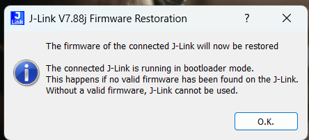

When I open jLink after the mcu led is in solid state, Jlink says that it is in bootloader. After which it flashes the OB and I get the below logs post which the MCU led starts blinking.
J-Link connection not established yet but required for command.
Connecting to J-Link via USB...Updating firmware: J-Link OB-nRF5340-NordicSemi compiled Nov 7 2022 16:22:01
Replacing firmware: J-Link OB-nRF5340-NordicSemi compiled May 18 2021 BTL
Waiting for new firmware to boot
FAILED: Could not read J-Link capabilities.
bytes, received 0 bytes !
Cannot connect to J-Link
J-Link>
Please help recover the board.
