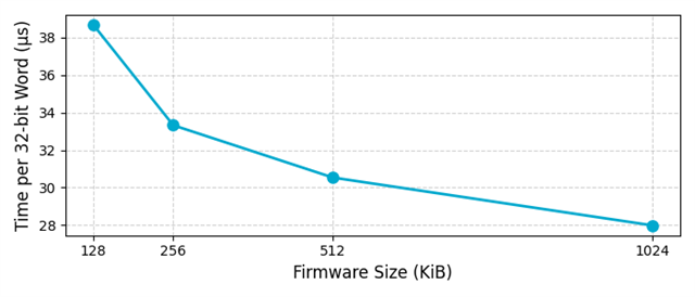

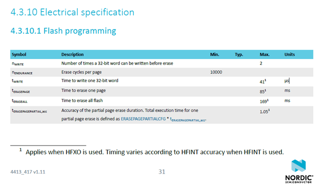

what's the typical flash erase and write time on nRF52840?
Hi there,
I found the FW swap time in Mcuboot is too long. debugging into the code, the function, boot_move_sector_up, take ~20s, my FW is ~600k. It means the flash erase and write time is about the max time in the datasheet. But the datasheet doesn't provide a typical time, is there anyone can provide the typical time?
Thank you.
