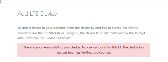

Issues connecting nRF9151-DK to nRF cloud
I am following the Cellular IoT Fundamentals course and trying to get my nRF9151-DK set up as a device in the nRF cloud. (https://academy.nordicsemi.com/courses/cellular-iot-fundamentals/lessons/lesson-1-cellular-fundamentals/topic/lesson-1-exercise-1/
I am in the United States and coverage technically should not be an issue. I am using the Conexa sim card that was provided with the nRF9151-DK.
Every time I try to add the device to the cloud I am getting "There was an error adding your device: No device found for this id. The device has not yet been just-in-time provisioned."
This is what the serial terminal is printing out while I am trying to connect the device to the cloud:

How can I get this device to connect to the cloud?
  • Hi Artiom,
    You’re seeing this because the device isn’t connected to the internet and therefore has not done provisioning. Could you try using Asset Tracker V2 instead of the Asset Tracker template and then share the logs?

    This is what I am seeing in the logs after a few minutes with the Asset Tracker V2. (I am still getting the error trying to add the device to the cloud.)

  • After trying to connect it to the cloud on the next day it finally worked with the V2, thanks!
