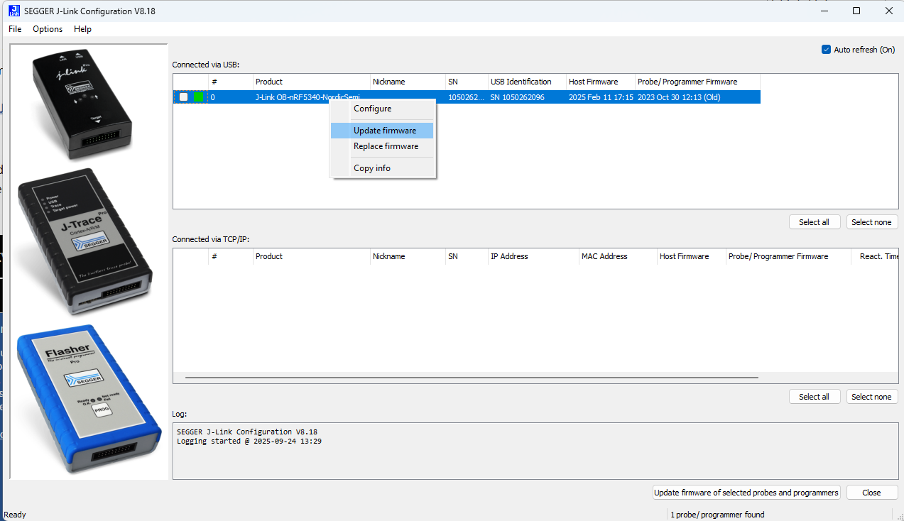

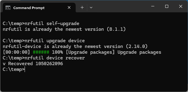

    If you haven't already, try to use the nrfutil directly from command line to see if you are for instance able to run the following 3 commands (you may also need to install j-link):
    If that doesn't work, then try to run JLinkConfig and right-clicking the probe, and then selecting Update firmware:
    Normally though, you don't need the Quick start, you may as well just follow: https://academy.nordicsemi.com/ Starting with https://academy.nordicsemi.com/courses/nrf-connect-sdk-fundamentals/
    Kenneth
  • Yep, that did it. The first `nrfutil upgrade device` command did not work. So I went to the jlink configure software and it said that there was no valid firmware on the board. I think it also said that whatever was on the board was from 2021 while the current firmware is from Feb of 2025.
    I was able to compile and run the hello world sample and have it print out.
    Thanks!
