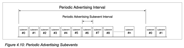

    Yes, that is how it should be. Ref this figure frmo page 3049 in BT core spec 6.1:
    However, if the controller does not get data in time it will send empty packet to that subevent. So i could be that some other processing or similar delayed this? As long as you stil get the data you need through, it should not be a problem.
