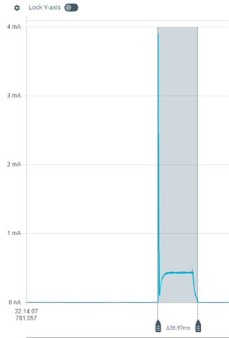

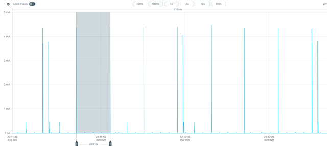

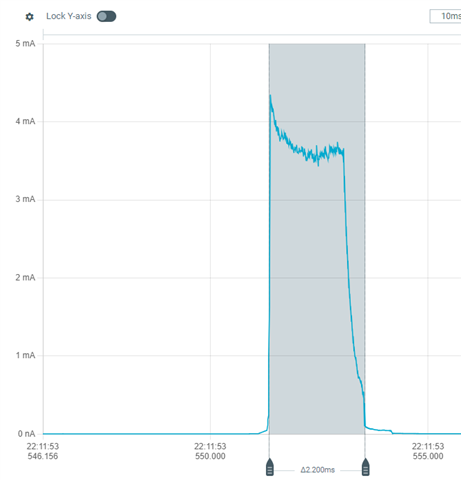

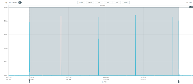

  • Also I can see current pulses from the SED like this, even when detached. Could you explain what are they? None of them seem to increase MAC counters, so I think none of these are actual radio tx/rx sessions(?).
    The pulses are like this in detail.
    Also there is another pulse here
    Which looks like this in detail
    I must admit that these pulses are unfamiliar to me. The current level could align with the radio being on, though the actual value is lower than the expected typical value from this table. The SED periodically turning on the radio and not sending parent requests in a detached state is also not expected behaviour.
    Since you are mentioning the lack of increase for MAC counters during these spikes, I assume that you are already sniffing and analyzing the packets?
    Are you able to get device logs from the SED? The current consumption will of course increase by enabling logging, but it could help to explain what the spikes are.
    The 8s interval spikes are strange, and I don't have a first step to begin to investigate those at this point. Sorry about that.
