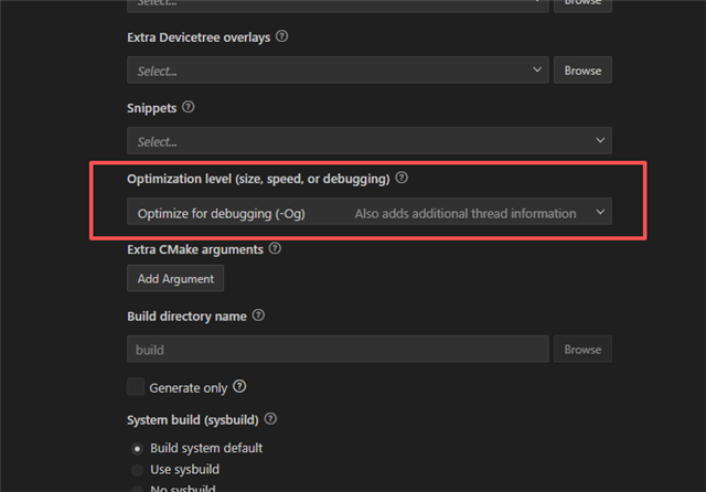

Hi I have updated th nRF Connect for VS Code Extension Pack to the newest version. But when I want to enter Debug in VSCODE, the error comes out. Before upgrade, the debug is ok.

    Yes, in multi-image (multi-domain) builds—such as when using MCUboot, TFM, and your application—each image/domain can have its own optimization and debug settings. By default, setting the optimization level to "debug" in your main build configuration only applies to the main domain (usually your application). This has been documented here: How to work with sysbuild domains
    So, to fix your issue:
    1. Go to the Build Configurations in VS Code.
    2. Edit the build configuration for the MCUboot domain.
    3. Set its optimization level to Optimize for debugging.
    4. Rebuild the project.
