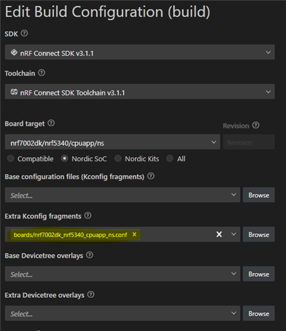

BLE provisioning example - errors when building with /nc
BLE provisioning sample fails with crypto errors when using TrustZone (/ns) board target on nRF7002 DK with nRF5340.
  • Hardware: nRF7002 DK (nRF5340 + nRF7002)
  • SDK: nRF Connect SDK v3.1.1-e2a97fe2578a
  • Zephyr: v4.1.99-ff8f0c579eeb
  • Board Targetnrf7002dk/nrf5340/cpuapp/ns (TrustZone enabled)
  • Samplesamples/wifi/provisioning/ble/
Working Configuration
  • Board Targetnrf7002dk/nrf5340/cpuapp (non-TrustZone) White check mark WORKS
  • Functionality: BLE provisioning and WiFi connectivity work perfectly
  • No crypto errors with standard (non-TrustZone) configuration
Problem with TrustZone
When switching to nrf7002dk/nrf5340/cpuapp/ns (TrustZone enabled):
Error Messages:[00:00:01.520,935] <err> bt_ecc: Failed to generate ECC key -134[00:00:01.520,935] <wrn> bt_smp: Public key not available[00:00:01.530,548] <err> bt_gatt: Unable to import the key for AES CMAC -134Impact:
  • BLE advertising starts successfully
  • WiFi provisioning service initializes
  • BLE crypto operations fail (ECC key generation, AES CMAC)
  • Likely affects BLE pairing and security
Attempted Solutions:
  1. PSA Crypto Driver Configuration:
CONFIG_PSA_CRYPTO_DRIVER_OBERON=y
CONFIG_PSA_CRYPTO_DRIVER_CC3XX=n
Result: No improvement
  1. Increased mbedTLS Heap Size:
CONFIG_MBEDTLS_HEAP_SIZE=32768 (increased from 8192)Result: No improvement
  1. Explicit Crypto Module Enablement:
CONFIG_MBEDTLS_PSA_CRYPTO_C=y
CONFIG_MBEDTLS_ECP_C=y
CONFIG_MBEDTLS_ECDH_C=y
CONFIG_MBEDTLS_ECDSA_C=y
CONFIG_MBEDTLS_CMAC_C=y
  1. Disabled PSA Crypto Drivers:
Commented out PSA driver configsResult: Same crypto errors persistExpected Behavior:BLE provisioning sample should work with TrustZone (/ns) without crypto errors, similar to how it works without TrustZone.Questions:
  1. Is additional TrustZone-specific crypto configuration required for BLE stack integration?
  1. Are there known issues with BLE crypto operations in TrustZone mode?
  1. What is the correct PSA crypto configuration for BLE + WiFi + TrustZone?
  1. Is error code -134 documented and what does it specifically indicate?
