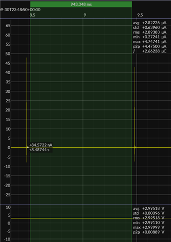

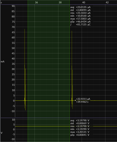

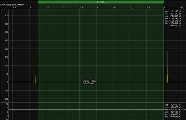

### Observed Behavior
* Floor current baseline: ~4 µA (no button interrupt configured)
* Floor current after enabling GPIO P1.13 interrupt (edge detection for button): ~23 µA

  • Hi Sigurd,
    Thanks for your reply. I tried your solution, but the floor current still remains around 23 µA. By the way, Motive is currently using SDK 3.0.0.
    Could you let me know what floor current you would expect when the GPIO is configured for both-edge interrupt?

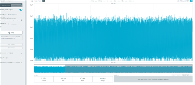

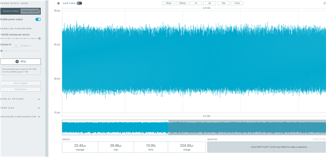

    3)
    When measuring the current, I get the same as you, around ~22uA:
    4)
    I then add  sense-edge-mask = <(1 << 13)>; to the gpio1 dts node, so it looks like this in the overlay:
    &gpio1 {
        status = "okay";
    I measure again, and I see it have dropped to ~3 uA
