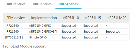

Is there an official support for nRF21540 for nRF54L10 ?
Hi, Emre.
Yes, this is confirmed by the currently latest Developing with Front-End Modules documentation.
Mathias
Are there any reference design for 54L15 with 21540 ?
Sorry for the delay, Emre.
We don't have a reference design combining both, so I'd recommend having a look at the separate reference designs for the nRF54L15 and the nRF21540, and then combine these in your own design.
