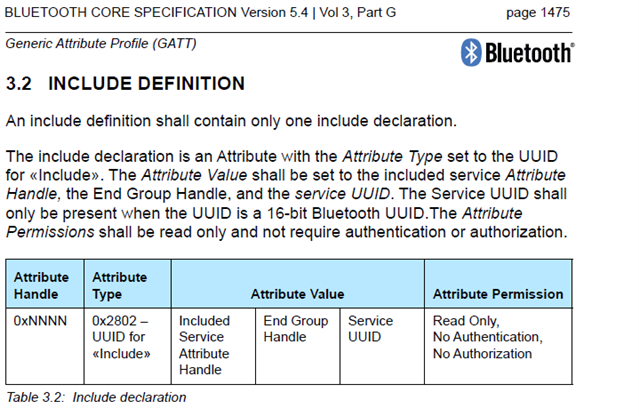

I have seen that since version 1.2 of Device Information Service (DIS) spec, it is theorically possible to have multiple instances of this service, by respecting the following rules:
  • No more than one instance of the Device Information Service may be exposed as a «Primary Service» on a device. One or more instances of the Device Information Service may be exposed as a «Secondary Service» on the same device.
  • A Device Information Service instance that is exposed as a «Secondary Service» must be included in another service

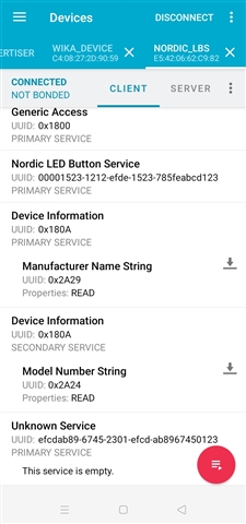

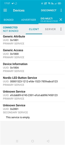

So I have a DIS declared as Primary service, and a second Primary service, which includes my secondary service, second instance of DIS.
After compiling flashing, I can see my Primary service DIS, my custom primary Service, and I see also a secondary service, but it is empty and has UUID 0x2801 as you can in picture:
Do you know what is the problem and how I can resolve this ?
  • Hi Antoine,
    I haven't tried your code but this seems to work for me. I modified lbs.c to add a secondary service in, I can see the characteristic of the secondary service.
    There is some warning but at least it built.

    We have to add it also in prj.conf: CONFIG_BT_GATT_DYNAMIC_DB=y
    Now I can see my secondary service DIS, included by my custom service:
    One question i have is : how can a user know that this secondary service DIS is linked to the custom service ? in the NRFConnect app, we don't really see the link
  • Hi Antoine,
    When you include a secondary service into the primary service, there will be an entry in the primary service called "Included service" as show below. When you do service discovery you should be able to read it. It contain the start and end handle value of the secondary service:
    I don't think we have good support for this secondary support feature in nRF Connect app. That's why you don't see the nested hierarchy in the app. We barely have customer using this feature actually. Most of the applications can be solved with just primary service.
