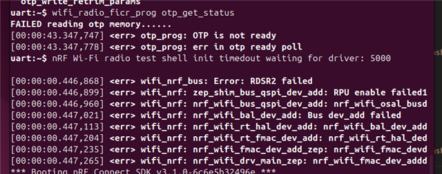

Hi all,
I just build the Radio Test code with nRF SDK v3.1.0 and it would have error accessing OTP.
Any ideas?
Hi all,
Any ideas?
This is on the nRF7002DK.

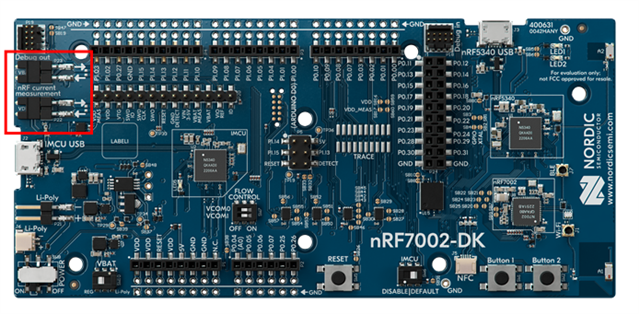

This error typically occurs if the nRF7002 IC does not get enough power. Can you check that you have the jumpers on P22 and P23?
You might have to turn the DK off and on again, then re-program.
Marte
