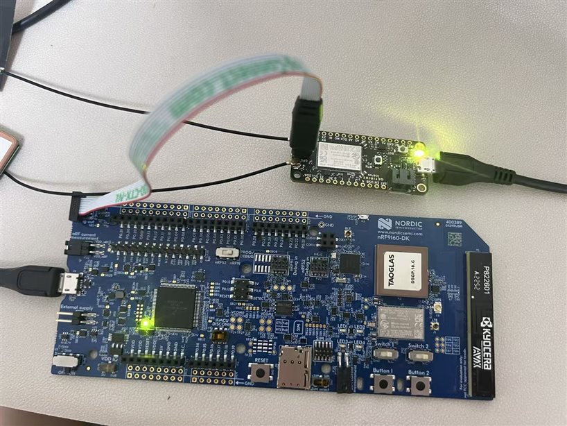

I'm trying to leverage the asset tracker project form nordic 9160dk to actinius icarus 9160 board, i use tagconnect 2030 to connect P19 of dk and icaurs, but the jlink cannot connect the board. I already register the board at actinius I/O, i'm sure i connected the tagconnect tightly. but here is the output of JLink:

here is how i connect dk and icarus:

    Have you set the "VDDIO" dip switch into 3V position? It is located just to the right of the power switch on the nRF9160-DK.
    If used often, these cables will degrade over time. Do you have another tagconnect to test with?
    The dk number is visible via nrfjprog --ids, but any --memrd or --recover command fails.
    Could you try to run recover in a loop via a batch script?
    :loop
    nrfjprog --recover -f NRF91
    goto loop
    Then power cycle your external board (icarus) and see if this is able to recover it.
