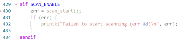

When I was running the dm process of Connect SDK 3.0.2. I wanted to make one device as the initiator and six devices as the reflectors.  I expect that the reflectors will not undergo scanning.I made the modifications based on this post:https://devzone.nordicsemi.com/f/nordic-q-a/99676/customising-distance-measurement-using-ndt/426102?focus=true#permalink=858951*/ for reflector.

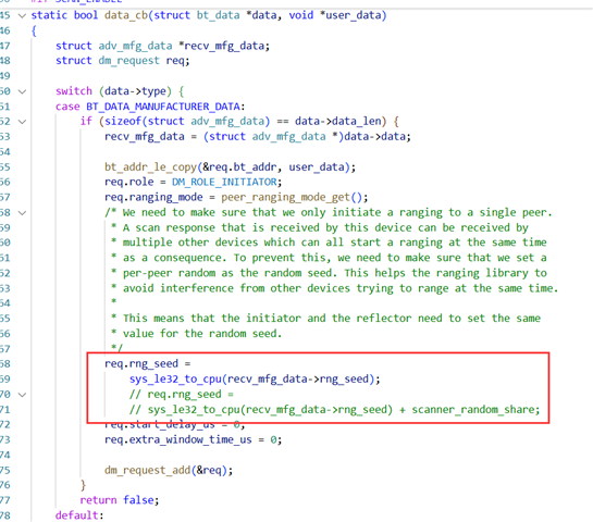

I made the following revisions  to the code of the reflector device::
In the main, these two positions have been commented out :
and  if (peer_supported_test(info->addr)) {}, Also, modify the method for obtaining the random seed

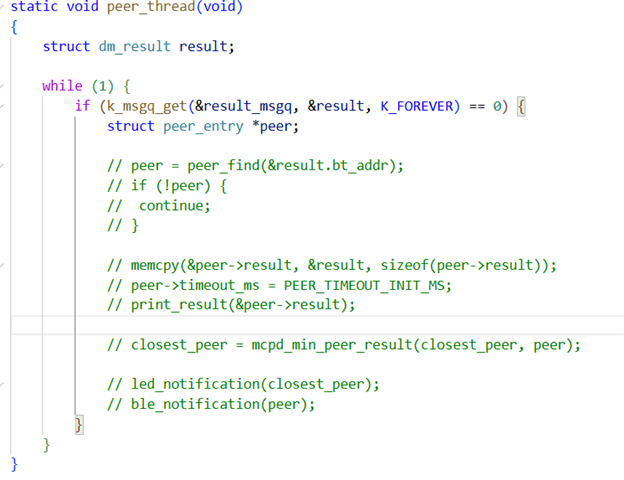

At the same time, comment out the following code in the peer file:
After I completed the two code modifications, I downloaded the code to the reflectors side. But at this point, distance measurement is impossible. Could you please tell me where the problem lies?.
    This seems mostly sensibel to me. But in order to understand more I have a few questions:
    • Can you share your modified project or a diff so I see all changes?
    • Are you using the unmodified nrf_dm sample as the initiator?
    • You write that distance measuremetn is impossible. In what way does it not work? Can you share logs?

  • nrf_dm_noscan.zipThis is the source code that the reflector does not scan.
    There are some changes there that I do not understand. Also, there is need for some changes on the initiator side as well to get synchronization working. Please see this modified maiin.c from the nrf_dm sample in nRF Connect SDK 3.0.2:

    @@ -119,7 +125,7 @@ static bool data_cb(struct bt_data *data, void *user_data)
     			 * value for the random seed.
     			req.rng_seed =
    -				sys_le32_to_cpu(recv_mfg_data->rng_seed) + scanner_random_share;
    +				sys_le32_to_cpu(recv_mfg_data->rng_seed);// + scanner_random_share;

    +#if SCAN_ENABLE
     	err = scan_start();
     	if (err) {
     		printk("Failed to start scanning (err %d)\n", err);
    +#endif
     	return err;
    With this, make sure you build with SCAN_ENABLE set to 1 for the firmware to run on the initiator, and set it to 0 for the firmware to run on the reflector where you do not want scanning. Note that with SCAN_ENABLE set to 1 the device is still multirole as in the sample and will work in the same way except for not using a per-peer random seed.
