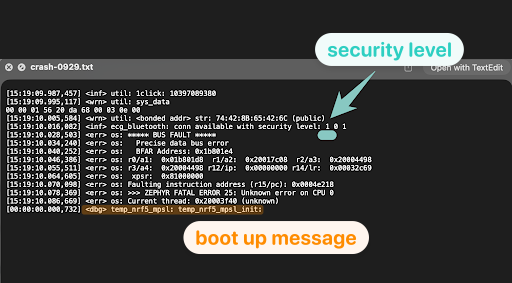

    I have minimized the log printout into the attached screenshot. This log is printed when a single click on a button is triggered.

        if (current_conn)
            LOG_INF("conn available with security level: %d %d %d",
                    bt_conn_get_security(current_conn),
                    is_streaming,
                    conn_param);
            print_connection_params(current_conn); // it goes here!!!

    As in the green annotation line, `current_conn` is available with the printed security level at level 1.
    `current_conn` is only established and referenced by `bt_conn_ref()` in `on_connected()` event. And `bt_conn_unref()` in `on_disconnected()` event
    (Please refer to my original post for how I used it)
    I can confirm that while in this error state, no other BLE scanner can "see" it (my device only accepts 1 connection).
    When connection is made, the BLE stack should have been transitioned its security level from 1 to 4 without any interactions from the app. But in this error state, nothing happened after connection is established between the iPhone Central and my device (acting as a Peripheral).
