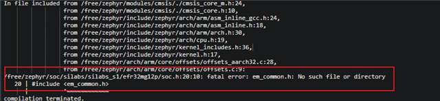

    I do not see any particular issue in your Partition Manager file. However, while reviewing the logs you shared from when you tried to build the Zephyr sample I mentioned, I noticed that the path indicates Silicon Labs EFR32MG12P. How did this SoC get selected during the build process?

    I’m not sure how that SoC was selected. I simply followed the link you sent: https://docs.nordicsemi.com/bundle/ncs-latest/page/zephyr/samples/drivers/jesd216/README.html

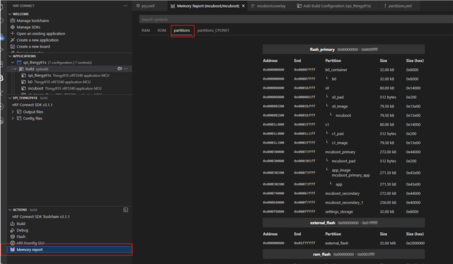

    From the partition details you shared, it shows: mcuboot_secondary.region = external_flash with device: DT_CHOSEN(nordic_pm_ext_flash), which confirms that the secondary partition is located on the external flash. On my end, the alignment looks correct, so I believe this is not an issue caused by the Partition Manager.
    You can also check the memory report in VS Code to verify whether the pm_static file you defined is properly reflected and placed.
    Additionally, please check why RTT is not working ,the logs could provide useful information about what or where exactly the crash is occurring.
