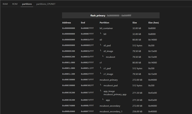

    I used the files you shared and tried to reproduce the issue. It builds fine for me, but when I check the generated partitions and the memory report, it appears that the external flash partition layout is not being applied. The secondary slots are still located in the internal flash.

    How do you build it ? The only build wich apply pm_static.yml file, I found is when i do :
    west build --runner nrfjprog -b {BOARD} -- -DPM_STATIC_YML=<file.yml>
    All other way does not work.

    Instead of using the command line, I used the VS Code extension to build the application you shared with the build configuration thingy91x/nrf5340/cpuapp, I used the pm_static.yml file located in the root directory of the application.
