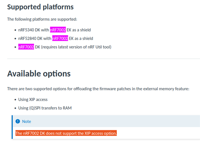

  1. Tried building without /ns suffix: Build failed
  1. WiFi Firmware Patches: I understand these could potentially be moved to save space, but I've seen Nordic support advise against relocating them - seems complicated with FOTA, but does give 83KB. I was not able to get this to apply to the project successfuly.
