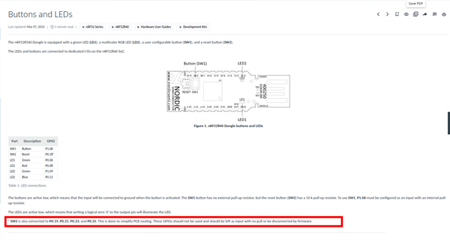

    Driving any of these pins low on the nrf52840 dongle will cause the bootloader to enter dfu mode (indicated by red LED) :
    Ref. https://docs.nordicsemi.com/bundle/ug_nrf52840_dongle/page/UG/nrf52840_Dongle/hw_button_led.html
