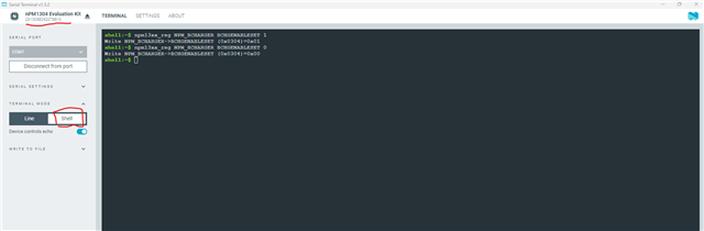

  • Hi Bill
    Connecting USB does not automatically activate the charger; it must be explicitly enabled via I²C.
    To exit this state, the host MCU must participate in the recovery process. In any PCM, if the OD (discharge) MOSFET is turned off, the only way to unlock it is by initiating a charge. ( Some PCMs, after an overcurrent event, require the VBAT pin to be raised to the battery cell voltage to unlock from the latched state also).
    So the practical approach is to momentarily enable the charger when USB is connected. Nordic’s default charger settings are safe and conservative typically 4 mA constant current and 4 V termination voltage—which is often sufficient to trigger a PCM reset.
    You can enable the charger by setting the BCHGENABLESET bit in the charger control register.
    The nPM PowerUP GUI may not be the suitable tool for triggering this fault recovery. Instead, you can use a Serial terminal app from nRF Connect for Desktop.
    See the attached image for reference for the correct settings.
    For example, on the nPM1304-EK, once a short-circuit fault occurs and the PCM enters a latched state (battery disconnected), you can connect USB (i.e VBUS powers VSYS + the host MCU power rail) and run the following commands to set the charger registers.
    # Enable charger
    shell:~$ npm13xx_reg NPM_BCHARGER BCHGENABLESET 1
    ( Optional setting : Set  BCHGVBATLOWCHARGE to enable charging at low battery voltage.
    shell:~$ npm13xx_reg NPM_BCHARGER BCHGVBATLOWCHARGE 1   )
    # Disable charger
    shell:~$ npm13xx_reg NPM_BCHARGER BCHGENABLESET 0
    This sequence will allow the battery to recover from the PCM locked state.
    Also note that the nPM1304 reacts faster and at lower current thresholds (IBATLIM) than the PCM for overcurrent events involving current flow from VBAT to VSYS.
    Regards
    Tharaka
