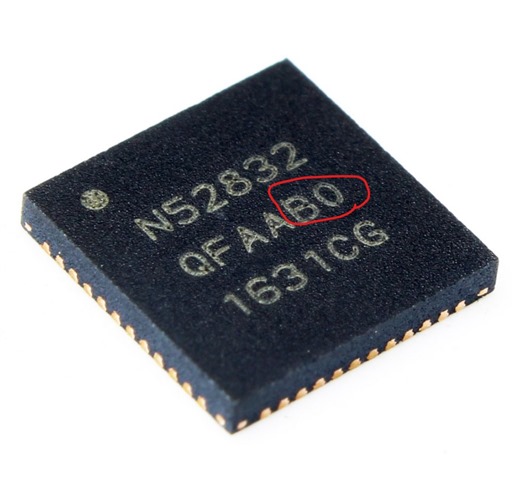

BLE_APP_UART Problem
I am designing a wearable device that uses BLE and UART. During the development stage, I worked with the nRF52 Development Kit and started with the ble_app_uart example from nRF5_SDK 17.1.0_ddde560. Everything worked properly at that stage.
Next, I designed my own PCB. As a reference, I used a Chinese module (XL52832.D01). This module also worked correctly. However, when I assembled the components on my custom PCB, some issues appeared.
Most of the BLE peripheral examples, such as ble_app_blinky and other peripheral demos, run without problems on my PCB. But ble_app_uart does not work. I tried changing many parameters and tested both the 32 MHz and 32.768 kHz oscillators. I could not find any hardware fault, yet ble_app_uart still fails to run.
I then checked the ERRATA documentation for possible causes. Eventually, I noticed something related to IC revisions. To investigate further, I ordered different revisions (E0, E1, and G0). None of them worked. Surprisingly, only revision B0 — the one used in the XL52832 module — works properly on my PCB.
Could you please help me understand why revision B0 works on my PCB while the others do not? And more importantly, how can I resolve this issue so that my design is compatible with all revisions?

    It is noteworthy that when I replaced the original nRF52832-QFAA-B0 chip with a new nRF52832-QFAA-E0 on the XL52832-D01 board, the behavior of the XL52832-D01, which had previously functioned correctly, changed and began exhibiting issues similar to those observed with my custom PCB.
    It seems initialization-related, possibly tied to SoftDevice enabling, clock configuration, or resource allocation. Any suggestions for capturing the specific error code (e.g., modifying app_error_handler) or other debugging steps would be greatly appreciated!

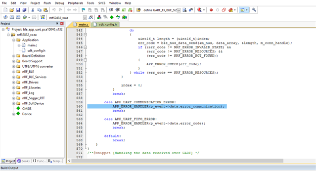

    I see. "Fatal error" is printed from the default error handler. Can you build a debug build where you have "DEBUG" defined and run again? Then the log should print the file name, line number and error code which will give us more information (see also An introduction to error handling in nRF5 projects for details on this). When you have that, can you let me know edactly which function call returns which error code?
  • Thank you, Einar Thorsrud.
    I rebuilt the project. With DEBUG enabled, I get NRF_ERROR_NO_MEM in APP_UART_COMMUNICATION_ERROR as below:
    This happens when using ble_app_uart on my custom PCB. Other examples (like ble_app_blinky) work fine.
    00> <info> app_timer: RTC: initialized.
    00>
    00> <error> app: ERROR 4 [NRF_ERROR_NO_MEM] at ..\..\..\main.c:560
    00>
    00> PC at: 0x0002C22
    00>
    00> <error> app: End of error report
    There is no errror check on line 560 in ble_app_blinky main.c so it seems like you ahve modified the project. Can you share your modified project? (Prefrably the whole project, but at least let me know the code around line 560 so that we know which function returned the error code.
    Thanks for the follow-up. I think there has been a misunderstanding: my issue is with ble_app_uart, not ble_app_blinky.
    The ble_app_blinky example actually works fine on my custom PCB without any problems.
    The error I reported (line 560 with APP_UART_COMMUNICATION_ERROR) comes from ble_app_uart, not blinky.
    Best wishes.
