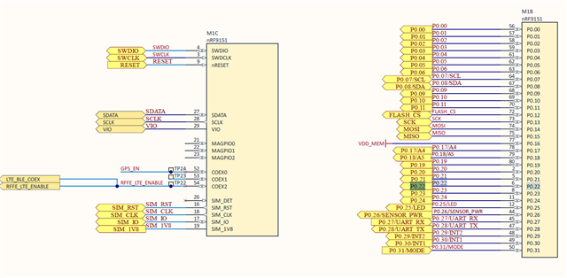

I am developing a custom IoT device based on the nRF9151 SiP with a Qorvo QM13345 SP4T antenna switch controlled via RFFE 2.1 interface. All RFFE AT commands fail with error 65536, preventing antenna switch control and resulting in no cellular signal (CSQ: 99,99).
## Hardware Configuration
- **Device**: nRF9151 (nrf9151dk/nrf9151/ns)
- **Antenna Switch**: Qorvo QM13345 SP4T (RFFE 2.1 controlled)
- **Current Modem Firmware**: mfw_nrf91x1_2.0.2
- **SDK**: nRF Connect SDK v3.0.2-89ba1294ac9b
- **Zephyr**: v4.0.99-f791c49f492c

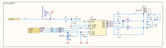

## RFFE Hardware Connections
nRF9151          QM13345
Pin 27 -------> SDATA (Pin 5)
Pin 28 -------> SCLK (Pin 6)
Pin 29 -------> VIO (Pin 4)
GND ----------> GND (Pin 7)
 **Connections**:
- SDATA (pin 27) → nRF9151 RFFE_SDATA
- SCLK (pin 28) → nRF9151 RFFE_SCLK
- VIO (pin 29) → nRF9151 RFFE_VIO
- RF1 (pin 3) → Main LTE antenna port
- RFC (pin 1) → nRF9151 RF output
QM13345 ID pin connected to solder bridge (SB1/SBI2) for USID configuration.

## Comparison with Nordic Reference Design
I noticed the Thingy:91 X (PCA20035) with nRF9151 successfully uses RFFE commands in its configuration:
From `/home/nrf/boards/nordic/thingy91x/Kconfig.defconfig.nrf9151`:
```kconfig
config MODEM_ANTENNA_AT_MIPIRFFEDEV
    default "AT%XMIPIRFFEDEV=1,4,71,198,248"
config MODEM_ANTENNA_AT_MIPIRFFECTRL_INIT
    default "AT%XMIPIRFFECTRL=1,0,1,28,248"
config MODEM_ANTENNA_AT_MIPIRFFECTRL_ON
    default "AT%XMIPIRFFECTRL=1,1,1,28,56,13,0,0,8,8,715,4,4,770,12,12,829..."
This confirms that nRF9151 SHOULD support RFFE commands for antenna switch control.

The hardware design follows the QM13345 datasheet requirements:
- RFFE 2.1 interface properly connected
- VIO decoupling capacitor present
- Proper grounding
- ID pin configured for USID=0x7 (GND connection)

  • I'm using MAGPIO exclusively and the CESQ is still 99,99,255,255. I am not sure why. I am using the sample applications from https://github.com/Conexiotechnologies/conexio-firmware-sdk/tree/main/samples/conexio_stratus and modifying it for my board.
    From what I'm seeing the COEX2 isn't being activated (pasted the pin diagram below):
    The GNSS IS working as long as LTE is off. LTE seems to block it.

    And the pin diagram:
    I have a feeling it might just be a software issue I'm not seeing.
    Can you please provide a full board layout for your custom IoT device? Please provide both schematics and layout.
    What antenna are you using in your design? The signal quality seems very low or non-existent.
