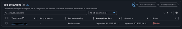

I created a job for my thing link with my job.txt, after fota error event here is what I see
for the moment in my code I only try to download, not perform update

and here is my terminal output
[00:03:38.554][INF].[aws_iot_event_handler:500] AWS_IOT_EVT_PUBACK, message ID: 21636
[00:03:38.713][INF].[aws_iot_event_handler:500] AWS_IOT_EVT_PUBACK, message ID: 13662
[00:03:38.724][INF].[aws_iot_event_handler:506] AWS_IOT_EVT_FOTA_START
[00:03:39.794][INF].[aws_iot_event_handler:526] AWS_IOT_EVT_FOTA_ERROR 0
[00:03:40.001][INF].[aws_iot_event_handler:500] AWS_IOT_EVT_PUBACK, message ID: 58818
[00:03:40.162][INF].[aws_iot_event_handler:500] AWS_IOT_EVT_PUBACK, message ID: 721
Download client say my bin file is not supported
<inf> download_client: Downloaded 2048/242388 bytes (0%)
<err> dfu_target: No supported image type found
<err> fota_download: Unknown image
My file (zephyr.bin) is the result of the build of my app located to build/zephyr/ generated by vscode. Should I do something particular to build bin for FOTA ?
