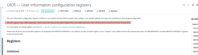

  • Tom Weber said:
    OTP can be written even if writing is disabled.
    The write enable bit is being set inside the nrfx_rramc_otp_word_write() before the actual write, then it's cleared again. See implementation here https://github.com/zephyrproject-rtos/hal_nordic/blob/979a58d0829108b57f10e90b6c3fc35ab6206e4b/nrfx/haly/nrfy_rramc.h#L406
    Tom Weber said:
    The nrfx_rramc_otp_word_write() function does not behave according to documentation.
    The behavior described in the API documentation does not correspond with the datasheet which states that you can only write once after an Erase All. I will forward this to the developers. Thank you for reporting this.
    Ref. https://docs.nordicsemi.com/bundle/ps_nrf54L15/page/uicr.html
