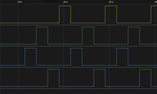

For starters I just want to see MCK, SCK, LRCK and SDOUT on the logic analyzer before managing buffering.

eg - I try the following, but I only see LRCK and SDOUT on the logic analyzer.
I had MCK working at one point but have lost that configuration with trial and error.

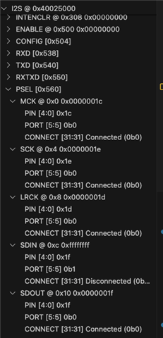

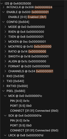

In Vscode XPERIPHERALS, I check the register for pin mapping,
Then I check MCKEN is set

    With the above code, SDOUT and LRCLK_M look great, but I cannot see SCK_M or MCK.

  • yeah I just tried with NCS. same result. Only LRCK and SDOUT are wiggling on the logic analyzer. I attached my project.

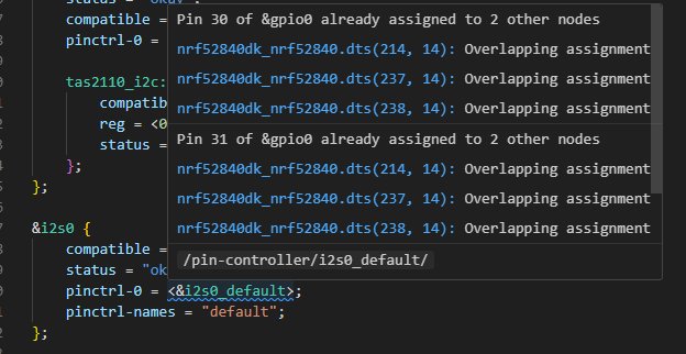

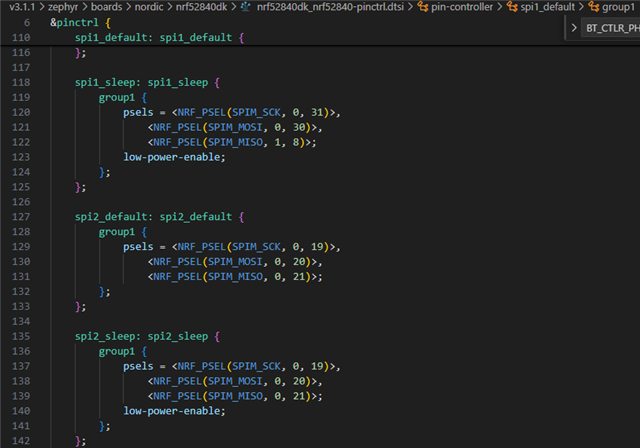

  • There are two obvious things that could be at fault here that comes to mind. One would be if you chose pins that were assigned to something else in the HW of the DK, and would maybe need to cut a SB to fix that (you can find these pins in the table underneath the DK). Another would be if you assigned another peripheral to the same pins. I am not seeing neither of this being at fault here.
