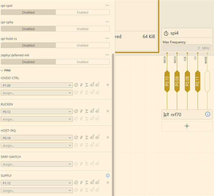

Hello all !
I'm currently trying to make a scan with our custom board, I've made a custom board with our GPIO and the use of the SPI4 instead of QSPI for the 7002 -> 5340 communication, we also use the CDC ACM USB to use direct USB connection for debug and terminal print / command.
In the scan project we have the main.c, in this main there is no indication of how the device is powered up (supply / IOVDD / BUCK EN), if I'm understanding correctly we are setting those up in the device three with the overlay / board configuration file :

For now I can build and program my board but I see that the power supply, io vdd and bucken is not enable, do we need to enable this on our side ? Or the device three with device 7002 on SPI4 with the given pin make this automatic, like in the pictures bellow :
There is also the board yml files, we add our two chips we use on board as in the 7002 DK board on the NCS :

  • I've know adding the power supply management in my main.c code, to enable the power supply know I get the OTP error but one other problem is that I get a lot of error cause the nRF7002 init is starting before my power supply start (even if it's the first thing I do in my main.c). So the driver does not handle the GPIO of the nRF7002 even if we had those in the .DTS board file ? Is there a way to start the WiFI init later ?
    [09:27:06.939] uart:~$ [09:27:08.126] [00:00:00.437,164] wifi_nrf_bus: SPIM spi@a000: freq = 8 MHz

    Is this only the OTP error or I need to solve the previous issue I think there is some error from the QSPI but I use SPI4 in my board files ?
    Cause I've seen this forum question and asking without programming the OTP : samples/wifi/scan broken without programmed OTP.
    Best regards, and thank you in advance for your response.
  • Another thing is that if you are uncertain about the connections you could test this with the "bustest", which you can find in zephyr/tests/boards/nrf/nrf70/bustest.
    What NCS version are you using btw?

  • Hi thank you for your response, I've actually managed to make a scan with my custom board, I did change the SDK to include the supply / Vbat power on, and now the device is enabling and initialising correctly !
    The change is on 2 files of the SDK wifi, on the  C:\ncs\v3.1.1\zephyr\dts\bindings\wifi\nordic,nrf70.yaml file, I add the supply-gpios option to activate or not an external regulator for the supply as we have on our hardware adding this :
    supply-gpios:
      type: phandle-array
      description: |
        Optional GPIO of the SoC controlling an external power supply
        (e.g., 3.3V regulator) that must be enabled before BUCKEN.
        This is for custom boards with an additional power stage.
        If specified, this GPIO will be enabled first, before bucken-gpios.
    Then I added the supply in the power sequence here "C:\ncs\v3.1.1\zephyr\modules\nrf_wifi\bus\rpu_hw_if.c", with the following addition :

    With this modification we enable first our 3V3 regulator before enabling the other power GPIO and the initialisation is fine.
    best regards, and thank you for your help on this issue !
    supply-gpios:
      type: phandle-array
      description: |
    //GPIO Specification (lines 38-41)
    #if DT_NODE_HAS_PROP(NRF7002_NODE, supply_gpios)
    static const struct gpio_dt_spec supply_spec =
        GPIO_DT_SPEC_GET(NRF7002_NODE, supply_gpios);
    /* GPIO Configuration (lines 177-232)
    - Added supply GPIO configuration in `rpu_gpio_config()`
    - Ensures supply GPIO is configured first
    - Proper error handling with cleanup*/
    // Power-On Sequencing (lines 254-307)
    static int rpu_pwron(void)
        // Step 1: Enable external supply (if configured)
            gpio_pin_set_dt(&supply_spec, 1);
            k_msleep(10);  // Wait for VBAT stabilization
        // Step 2: Enable BUCKEN
        gpio_pin_set_dt(&bucken_spec, 1);
        k_msleep(1);
        // Step 3: Enable IOVDD_CTRL
        gpio_pin_set_dt(&iovdd_ctrl_spec, 1);
        k_msleep(iovdd_power_up_delay_ms);
    // Power-Off Sequencing (lines 309-334)
    - Reverse order: IOVDD → BUCKEN → SUPPLY
    /* GPIO Cleanup (lines 234-260)
    - Added supply GPIO disconnection in `rpu_gpio_remove() */
