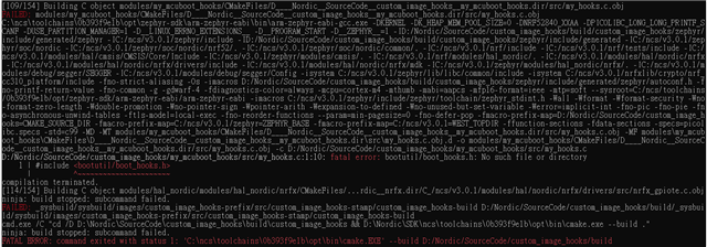

  • Yeh , the problem with that is compiler won't recongize the libray MCUBoot is using

    any thought on how do i compile a Mcuboot hook ?
  • The module does not include the neccessary include paths. You can make a copy of this header and include it in your module or specify the include path with target_include_directories the module's cmakelist file.
  • Did you try to specify the missing include paths as I suggested?
