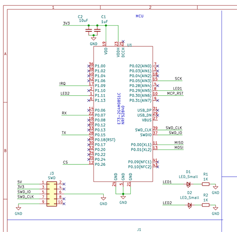

I'm trying to use a nrf52840 as a central device and connect to a gopro13. The connection works a certain number of times. But after a while (several days or maybe several connections), the connection fails. Other devices (phone, remote control) successfully connect to the GoPro. If I start the pairing process on the GoPro, the connection will be successful and will work for some time.
More details:

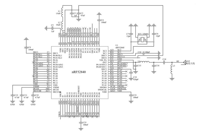

My device is based on  Ebyte E73-2G4M08S1C module.
Ebyte E73-2G4M08S1C schematic
My device shematic:

Debug output when connection fails:

[00:00:14.220,245] - settings loaded successfully
[00:00:14.220,397] - Saved bond found: C6:D9:69:8A:22:91 (random)
The address is correct, this is my camera. I think we can say that the settings were saved and loaded successfully.
The connection to the camera only starts if the camera is turned on. This is indicated in the advertising ( eir_found function).
To connect, I call the bt_conn_le_create function. In the callback, I display a message that the connection has been established and try to change security level to BT_SECURITY_L2:

By the schematic, my module doesn't have an external 32kHz crystal. Therefore, in the board settings ( https://github.com/Sergey1560/nrf52_gopro_zephyr/blob/master/boards/vend/goprocan_nrf52840/goprocan_nrf52840_defconfig ) , I use:
CONFIG_CLOCK_CONTROL_NRF_K32SRC_SYNTH=y
CONFIG_CLOCK_CONTROL_NRF_K32SRC_XTAL=n
