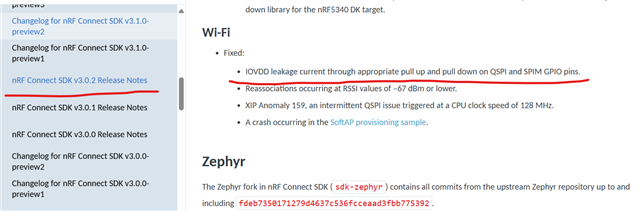

According to the nRF7000 specification, the sleep current should be around 15 µA. Electrical specification.

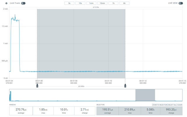

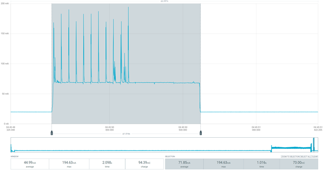

We have a custom PCB with nRF9160 + nRF7000, and the issue is that after enabling nRF7000 support in the application, the idle current of the PCB increases by about 160 µA.

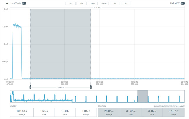

Without nRF7000
With nRF7000

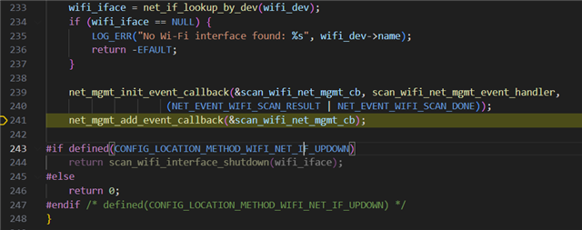

For data collection, we use the Location library, and we expect it should handle the nRF7000 power modes automatically.
