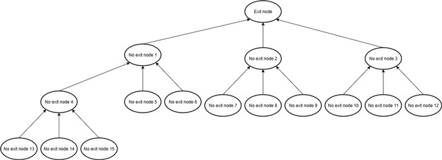

There are many tickets about this issues, I try them all. The only change really helps was to remove all the hci call from the sys queue, but it is still happening a lot. I found the request to getthe connection RSSI is causing the assert.
I had work on this issue for a month now. I saw this assert when I testing in high traffic BLE environment. Each device has 4 BLE connections where each device send data to one connection every seconds and the RSSI is been request every 5 seconds.
