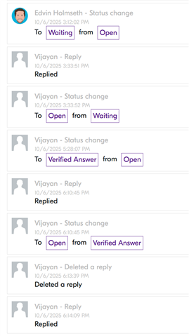

    It is not closed. It is open. But it did have the status "Verified Answer" at some point:
    So if you press "Verify answer" on one of the replies in the ticket, it will get this state. But if you then later reply in it, it will go back to open.
