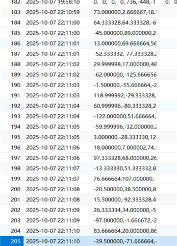

I can now obtain my IQ score. May I ask how to increase the speed of obtaining this score?
I have modified the code according to your suggestion. Now the IQ data can be captured twice within one second. May I ask if it is possible to further increase the capture speed? What parameters need to be adjusted if we want to further improve?
Hello,Edvin,Can we continue to increase the speed of distance measurement?
I am not 100% certain it is possible to increase it much more. Channel sounding requires a lot of radio activity, which takes a bit of time.
Can you, however, upload what you currently have? Then I can have a look, and try to tweak some CS parameters, to see if it is possible to speed it up.

Can you please try the following:
Decrease this:
Decrease the ACL interval:
Note that if you decrease the procedure interval by "too much" there will probably not be enough time for the RAS (Ranging service) to relay the CS measurement data from the rrsp to the rreq before the next proedure starts. This will lead to dropping some of the procedures, and perhaps an effictively reduced rate of new distance estimates.
One option to combat this issue is to reduce the amount of CS measurement data of CS measurements data per CS procedure. Note that this will always be at the cost of reduced accuracy. This could be done in a dew different ways.
Reducing the number of enabled channels in the channel map by settting fewer bits here:
Reducing the subevent length (1) and configuring the max_procedure_len subevent len (2)
Configuring the submode as unused here:
(this may reduce the security of CS)
