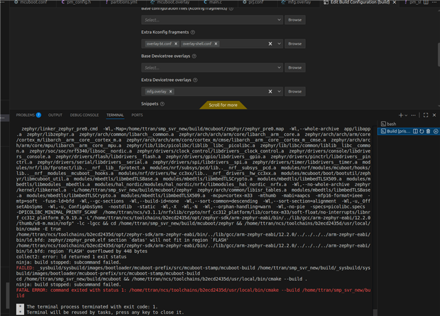

I am trying to define a pm_static.yml file which will use the 512K ram on the nrf7002dk_nrf5340 for the TFM ram section.
I cannot compile the non-secure nrf7002dk/nrf5340/cpuapp/ns but I can compile the nrf7002dk/nrf5340/cpuapp.
For the non-secure, it compiles that it cannot fit it into the RAM region.
I have included my sample project but looking for some help with the secure configuration.  I don't need to use the TFM.
It doesn't have to be a secure configuration, just trying to get something to compile and boot with the spi external flash configuration for DFU purposes.
smp_svr_new.zip
This is my sample project that has the custom configuration.

When I compile the nrf7002dk/nrf5340/cpuapp and flash it to the custom board, it says 'Unable to find bootable image'.
Hopefully, you can see something off with the pm_static.yml configuration file.
Tom
