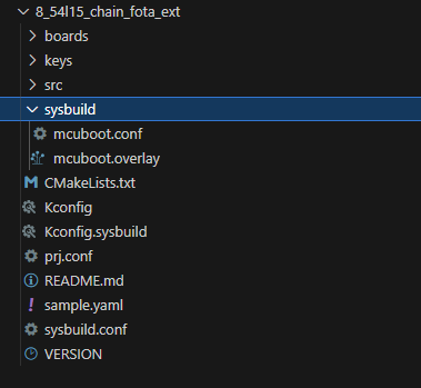

    Whenever you add mcuboot through sysbuild, the build system will use the default mcuboot that is within <sdk>/bootloaders folder. Whatever you apply to your projects mcuboot/prj.conf will only have any effect on this specific project and not the bootloader in the SDK.
    For instance in this sample I have some project-specifc configurations within sysbuild/mcuboot.conf that only applies to this project and doesn't modify the source mcuboot configuration.
    However if you end up modifying anything directly within <sdk>/bootloader/mcuboot, where <sdk> is the NCS installation you have present, this will affect every build that you do in any project that is using this NCS version.
