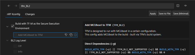

Is there anything I can do to set TFM_BL2 and TFM_KEY_FILE in the build output?
    have you tried deleting the build folder and build again? Have you tried setting the kconfig using menuconfig or similar?

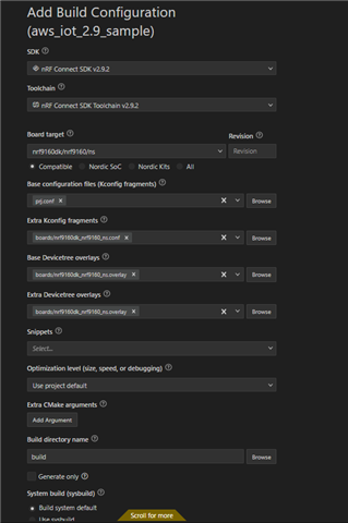

  • have you tried deleting the build folder and build again? Yes, I have
    Below is the build configuration that I've set.
    Have you tried setting the kconfig using menuconfig or similar? The option in the Kconfig GUI is greyed out.
    Below is the output after hitting "Generate and Build". Are there any examples/samples I could do which have "CONFIG_TFM_BL2=y" in the prj.conf? Do I need to do more than just set these values in my prj.conf and hit "Generate and Build"?
