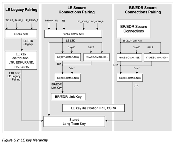

    I am able to see the  the key in own_ltk but peer_ltk is empty.
    My device is a peripheral device and I am using JustWorks for pairing with LESC turned on.
    The description in the own_ltk says that tLocally generated long-term encryption key (LTK) and master ID, distributed to the peer.
    Does it mean that during pairing this key gets transferred over the air to the central device?
    The peer manager was written a good while ago and I am not sure why the choises was made to organize the data as it is. But it is likely related to that the type of information sent from central to peripheral and peripheral to central differs from LESC and legacy pairing (you can see the details in BLUETOOTH CORE SPECIFICATION Version 6.1 | Vol 3, Part H). Also, from page 312 you can get an overview (the right most for BR/EDR is not relevant for BLE):
    No, when using LESC no keys are transmitted in clear and there is no way for an evesdropper to calculate the key as a Diffie–Hellman key exchange. However, for legacy pairing it is possible to eavesdrop on the pairing process, which makes legacy pairing insecure.
