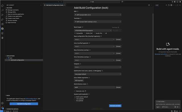

Add Build Configuration (added target which nordic recommends (with /ns))
proj.conf and other files are original (I didn't edit it).

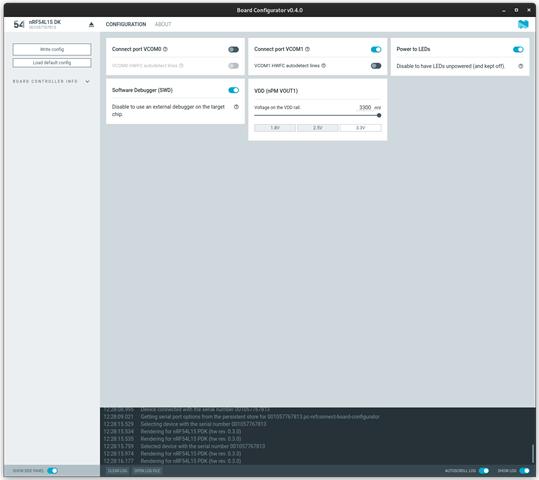

After compiling and flash it - nothing in UARTs VCOM0/VCOM1

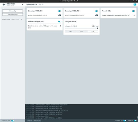

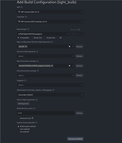

    try to build it with prj.conf and ns.overlay, also check the VCOM1 is connect in board configurator.
    real Matter Over WiFi on nRF54L15-DK
    nRF54L15 is not a WiFi device , its a Thread device (Matter over Thread will support)
     nRF7002 DK will support Matter over Wifi
  • Sorry, my mistake. I mean "Real Matter Over Thread".

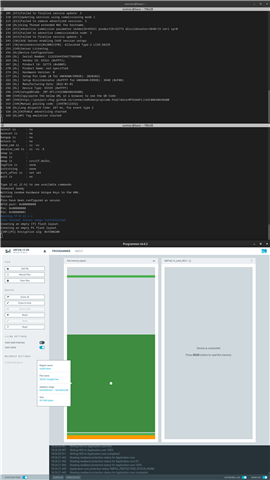

    I added config like you said. But there is still no logs on VCOM1/0 (UART).
    I also tried force torn it on:
    # Enable all debug features
    CONFIG_USE_SEGGER_RTT=n
    CONFIG_SHELL=y
    CONFIG_OPENTHREAD_SHELL=y
    CONFIG_CONSOLE=y
    CONFIG_UART_CONSOLE=y
    CONFIG_SERIAL=y
    CONFIG_LOG=y
    CONFIG_LOG_MODE_MINIMAL=n
    CONFIG_ASSERT_VERBOSE=y
    CONFIG_ASSERT_NO_FILE_INFO=y
    CONFIG_PRINTK=y
    CONFIG_PRINTK_SYNC=y
    CONFIG_THREAD_NAME=y
    CONFIG_LOG_DEFAULT_LEVEL=3

  • check the build log it seems to be like this
    Building light_bulb
    west build --build-dir /home/sunmac/office/ncs/works/scrap/light_bulb/build /home/sunmac/office/ncs/works/scrap/light_bulb --pristine --board nrf54l15dk/nrf54l15/cpuapp/ns --sysbuild -- -DCONF_FILE="prj.conf" -DDTC_OVERLAY_FILE=boards/nrf54l15dk_nrf54l15_cpuapp_ns.overlay
    and do eraseall the nRF54L15DK board and try to flash the sample, once done, check the VCOM1 COM port and also in DK LED1 is blinking

  • Still nothing. Did you edit config? And could you send me your merged.hex for test?
    As I see you using linux. Im using Mac and windows. Can it be a problem?
    My merged.hex:
    50625.merged.hex
  • Your Merged.hex is worked for me
    please check and confirm the LED0 is blinking after merged.hex flashed on the board
